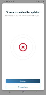

I've tried the Factory Reset multiple times, and the camera still refuses to sync to the base station. I've also tried the manual sync, removing the camera from my account first, then holding the Sync button down for 15 seconds. That does not work either, the LED never flashes amber like it should. The only way I can add the camera to my account is by syncing with WiFi. Even syncing with WiFi does not work properly, because the 'Firmware Update' continually fails, and the manual firmware update reports 'No updates available', even though it's still at version 1.080.18.4_52_ec35062.
There are other anomalies with this camera also. Any attempt to change video or audio settings results in an 'Operation Failed' message. I did a chat session a couple days ago concerning this problem, and have a case number : 43326307.
This is the Update Failed screen :
