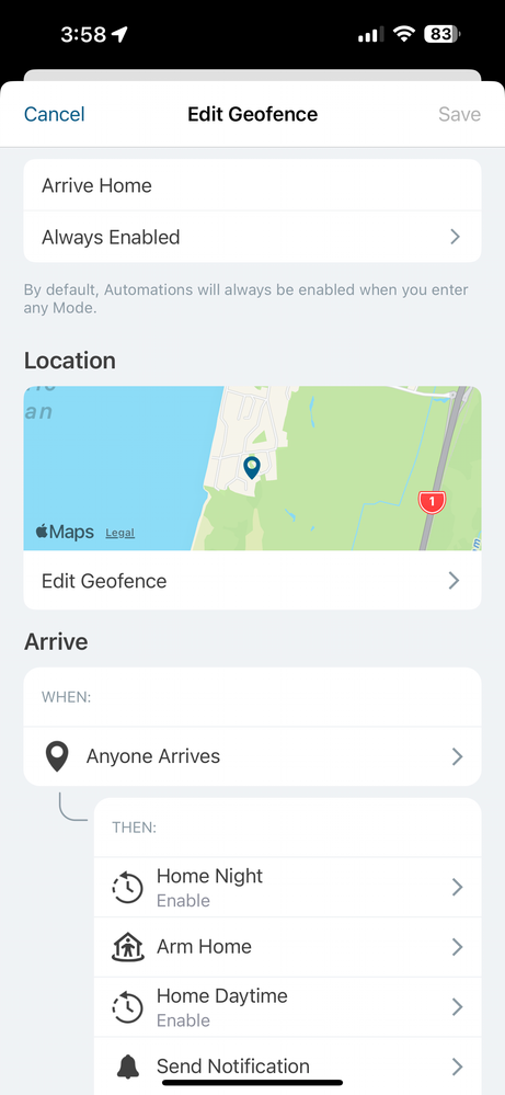

I can confirm that leaving home and the geofence zone during Standby mode does now go into Arm Away mode and on return home its reverts back to Standby mode if my return is within its set time period.
What was required for this fix: All three 3 Modes should have all automations selected. In my case this is the two schedules for daytime and night time periods, and the arrive and leave automation.
The logic to prevent conflicts and switch mode correctly is set in the automations tab for the leave and arrive, see screen shots.
