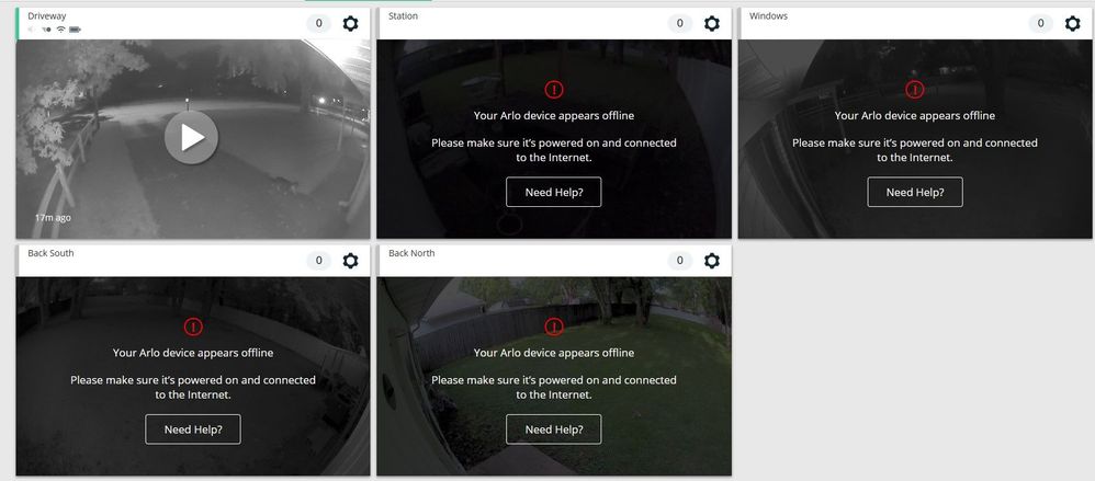

Out of nowhere last night one of my Arlo pro4s went offline. All my other cameras are online . I tried rebooting router and un inserting the battery . When I un inserted the battery and put back in the LED blinked blue rapidly, then picked up motion worked for an hour then offline again. What else should I do and why could this be happening? Does the update have something to do with it?

Having an issue that started a week or so ago. All 3 cameras go offline when it becomes dark. I noticed 2 red leds on all 3 cameras lit. The batteries are being drained and cameras non responsive with motion. As soon as the sun comes up, cameras react properly again.

Within the last two days, we had three of our cameras go "offline" without any notifications.
When the first one went offline we changed out the battery, back "online" and working. At that time I checked all cameras battery levels, and none showed low, in fact two showed fully charged, which surprised me as I had changed the battery several weeks ago.
Last night when we went to set the alarm, the two that had showed fully charged were "offline".
We had not received any notifications about battery levels for any of the three cameras. I changed out one of the cameras with a fully charged battery, the second one I brought into the house, pulled the battery, then placed it back in the camera. The camera booted up, went "online" then sent a notification email that the battery was down to 2%.
