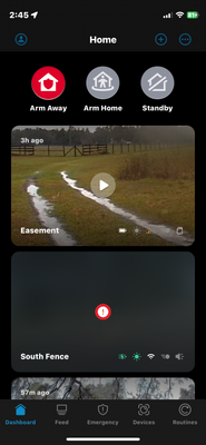

StephenB, I just now held my breath, used the 5S add device approach and the new UI apparently installed OK.
All my Pro4 cameras still seem to be working ( including all the terrible audio crackling noise ).
Now I’m going to test each camera and see if they activate alerts & videos.
thanks again for your excellent help.
FWIW Update reference "new UI"...working on figuring out the basics.
So far, haven't seen any alleged improvements over the tried & true "Library UI" version...so far, navigating its functionality is a pain.
IMO:
The 'new Feed UI' version design / layout / terminology does not make it very intuitive / user friendly like the "Library UI" version was.
Very mis-leading for the new Feed UI to be referenced / claimed to be an improvement over the Library UI from an end user perspective.
Planning to use the new UI with my existing set of ( noisy ) Pro4 cameras for a week or two and see if its usability settles down.
Then I'll decide if I want to stay with Arlo and install 5S cameras or not.
