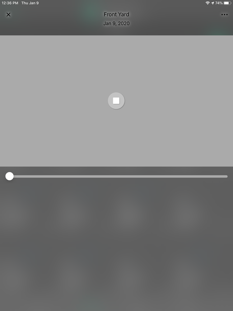

I have the Arlo ultra camera system and have a microSD card inserted into the base station. When Arlo released the option for direct storage access on the Arlo App I was able to watch videos from the direct storage access with no problems, at least for a couple days. Now anytime I access direct storage and attempt to watch a locally recorded video I get a gray screen and no video. It’s that way for any randomly selected video. Is there something wrong with the software/app? My microSD is perfectly fine. I have 4 Arlo Ultra cameras connected to Base Station model VMB5000rs.
I would just suggest you check that all of the connectivity stuff matches. You may also want to restart the hub and set the hub up with a DHCP reservation on your router so it's ip doesn't change.
My issue is now fixed and I can now access local recordings. I had to do a restart of the base station from the Arlo app and this fixed it. While I don't need port forwarding, one thing I did was enable port forwarding in the app (but didn't mess with my router). When I enabled it from the app, it was showing the IP address of the base station as 0.0.0.0, which didn't seem correct. I then hit restart and all worked once it came back up.
Interestingly enough, I did a few hard resets by unplugging the power and nothing changed, but perhaps hitting restart in the app does a different type of restart.
For everyone that had replied to this issue. I have tried all of the suggestions and I still have the same problem. After sifting through a ton of videos from the direct/local storage it seems like 50% I am am able to view from the app and 50% just give me a gray screen with no video. I check the time stamps from the direct/local storage compared to the cloud and I can view the video(s) from the cloud but the same video(s) I cannot view from the direct/local storage through the app. I also have the most up to date Arlo app. See attached photo of what I see from the app when trying to view videos from the direct/local storage.
