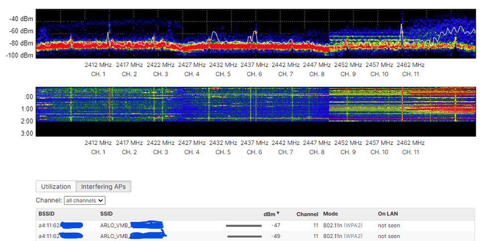

We really need a way to manually set the 802.11 channel that the Arlo uses. It keeps causing interference and performance issues for clients on the network. If I manually set the channel on the wireless APs the Arlo automatically jumps to the same channel within minutes. See the screenshots below. I changed the AP channel from 6 to 11 and the Arlo immediately followed.

Well, the repeater trick seems to have worked for getting the Arlo to stay on a channel other than the WiFi network. I set the repeater channel to 6 and plugged it in within a few feet of the base station and the Arlo has stayed on channel 6 while the two WiFi APs are on channels 1 and 11. Unfortunately, none of the Arlo cameras will connect to the base station like this. If I unplug the repeater the Arlo cameras will reconnect. Appreciate the suggestion but if the cameras don't work this really isn't a solution either.
Scratch that - the Arlo eventually went back to channel 11... Just took a little bit more time.

Can you confirm whether your SmartHub is still following the channel of the strongest signal it detects at boot?
I've been using the workaround that StephenB mentioned, placing access points beside my SmartHubs to steer them onto the channels I wanted. Occasionally they would jump to other channels by themselves but restarting the SmartHubs would always put them back on the channels I wanted - the channel of the strongest SSID it detects at boot. They would stay on that channel for days to months.
Recently one of my SmartHubs has started behaving differently. It no longer follows the channel of my 'steering' access point (on channel 6) but now always starts on channel 11, the same channel as both my other SmartHub and an access point located at the other side of the house. This is despite the steering AP on channel 6 being located very close to the SmartHub.
Has the WiFi behaviour of the SmartHubs changed with the latest firmware? (I have 4540 hubs, new firmware released on April 26th).
I haven't attempted any further tests since last time. I had put the repeater right next to the hub and initially the hub locked onto the same channel as the repeater but eventually switched to the channel of an AP on the other side of the house. Could be the AP still had a stronger signal than the repeater, but the repeater was literally right next to the hub.
