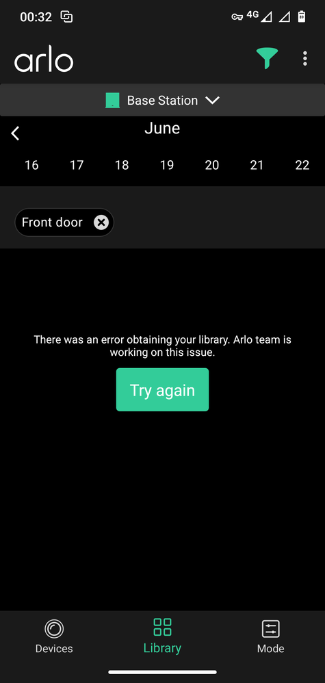

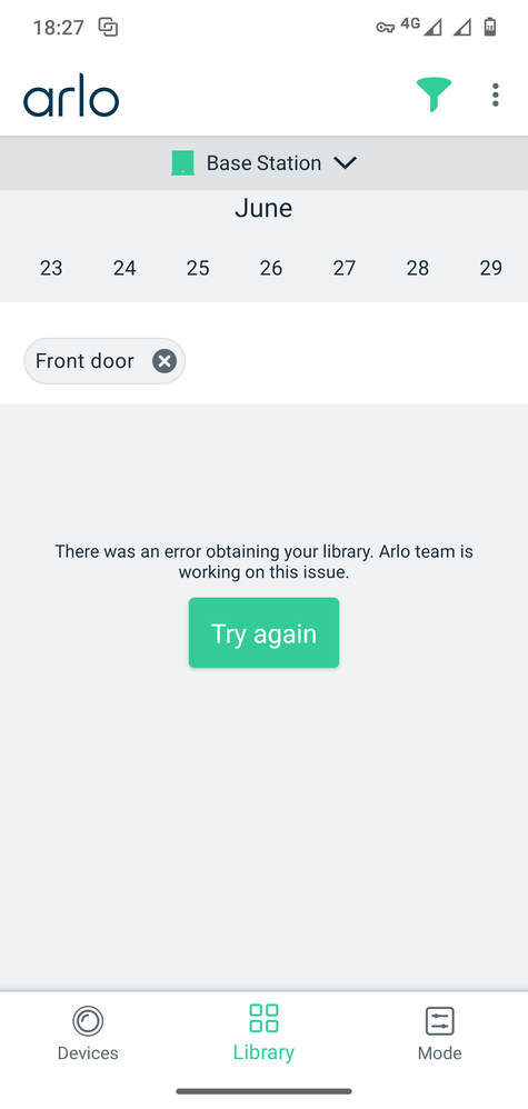

I can confirm it still does not work for me. I have:
Stock standard IPSEC VPN into Asus RT-AC86U
Samsung galaxy S9+ with up to date firmware.
I get the dropdown for cloud vs Smarthub but when I chose the smart hub I get a message "There was an error obtaining your library. Arlo team is working on the issue."
That's the same error I've been getting for months and if I were confident Arlo were really working on it, I'd be mildly happy but I don't have that confidence.

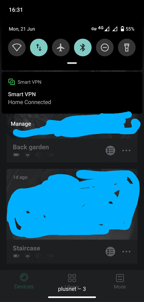

Firstly, I've set up a VPN on my Draytek router and use their VPN app to connect via a VPN tunnel (SSL tunnel, to be more precise).
Secondly, I open the Arlo app on my Moto g7 phone and from there, I can access recordings.

@Edinburgh_lad1 That image seems to be showing your arlo devices which your phone would get from the arlo portal via your internet access (be that direct via split tunnel or through your VPN tunnel and out to the internet from your router).
The true test, and what everybody's gripe is, is if you can see the videos on your local storage/SD card. If you go to Library in your app, there should be a drop down menu to choose Local storage or Portal (I can't recall the exact terms). If you can actually see a list of videos on you local storage, you have it working, otherwise it's broken for you like it is for the rest of us android users.
Please let us know how you go.
