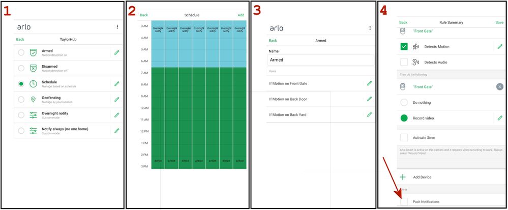

Attached are screenshots of the set-up. They show:
1) the system is always set to Schedule unless we are on holiday
2) the schedule set up (6.30am to 10.30pm is 'Armed', outside that time is 'Overnight notify'
3) inside the 'Armed' schedule..
4) push notifications are OFF (I only show one of the cameras here, but all three are the same)
The system *does* change modes correctly between Armed and Overnight Notify. But I still get push notifications when it is set to Armed.
I have checked the settings on all three cameras on the app and via the My Arlo website.
