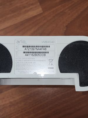

It would also be useful to know the base station model. Look for a label on the base that starts with VMB.

and the hub base:VMB4540.
