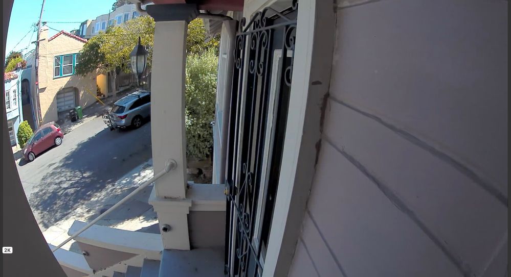

Observations: False alarms are triggered when cars are passing by (both day time and night time). The visual RGB pixels don’t show any difference (noticeable) in the regions masked by the activity zone.
If there are no IR blocking filters in these cameras (to facilitate night vision in b/w) and if said IR photons are reaching the sensor (reflected off car onto walls inside activity mask) then that activity has to show up as a pixel value jump on the converted image that is shown ,,, no ?

Firstly thanks for your suggestions and taking time to debug my problem. Here are two photos that show the issue, one has the car (snapshot of the moving vehicle) from the recorded event and the activity mask set by me.

Two photos as mentioned above.
