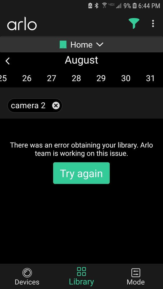

For the past several days my library is unavailable. The library is stored on an external hard drive and worked properly for several months. The unit has been in operation since 11/2020 in it's current configuration. I had previously had a similar issue in July 2021. To fix the issue in July I uninstalled the App and re-installed the App 3.5.3 from then on it worked fine until several days ago. Now I receive the following note when trying to access my library, "There was an error obtaining your library. Arlo team is working on this issue." And then it has a box highlighted with the phrase "Try again." I have not made any changes to my settings, typical Arlo... it just stops working properly for no known reason. I did re-install the app again but the error message is the same.

Without doing anything, the library for this smarthub is now showing available on my app. The system is great when it works properly. But it does try your patience since it just quits without any reason and starts again several days later. This has become a more common accurence over the past 2 months.

And here we go again... same problem. Uninstalled the app, reinstalled and I still have this error. This has become too common of an issue.
