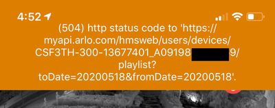

I came here to make my first post about this specifically. It started happening just after midnight EST yesterday (5/18). I also tried restarting the base, turning off/on the cameras in the app, and pulling the batteries to reset the cameras individually. I have three Pro 3s, they're all brand new in the last two weeks, firmware is current, and they're all plugged in to official Arlo outdoor power cables.
When I check the CVR timeline, it typically shows zero recordings between midnight on the 18th and now; however, if I try over and over again, it will occasionally show the CVR footage during that period, but with numerous interruptions, where it looks like it stopped recording or lost connection. So essentially, 95% of the time I check the CVR timeline over this time period, it shows no recorded footage, but will then every so often show footage as it should, so I know it IS actually recording properly.
In addition to the above, smart person alerts were lagging by 20-30 minutes today, from when I would walk through the activity zone, to when the notification would pop up on my iPhone and the motion would show up in the history within the app.
Not sure if related, but I started receiving this error message around the same time that I noticed my cameras weren't working as described in this post and the OP (covered portion of S/N):
