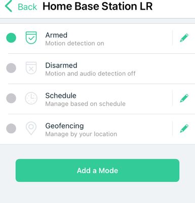

When I hit the mode button it shows arm all devices and disarmed on top then it says My devices with my home hub listed under it. When I hit Arm all it only arms the doorbell because under the armed mode motion on doorbell is the only one mentioned. But I’m not sure what happened because I’ve never had this issue before

I figure it has to be connected to the wifi when I do the new device hook up process. Wouldn’t you think? Plus I can function it with my phone. Unless it’s acting like a Bluetooth apparatus ? How do I do a hard reset on the floodlight? Because I remove device to try again and again and the same settings that I previously programmed are still on the app

Yes I am. I have it added as a rule under the “Armed” mode. When the doorbell detects motion the floodlight also goes off now. But it sucks because without the doorbell the floodlight won’t work on its own.

This sounds like you accidently set up a cross-trigger instead of an independent rule.
A cross-trigger is when you set up a one camera (e.g., the floodlight) to record when a different camera (e.g., the doorbell) detects motion.
So take another look at what you did in "armed".  If you added a record action to the doorbell rule, then you did the wrong thing.  Delete that action, and add an independent rule for the floodlight.

 I did purposely add the floodlight to the doorbell because the doorbell is the only one listed under the armed mode . And I’ve tried adding a new mode for just the floodlight but it only lets you chose one mode at a time . If I chose this new one with the floodlight then the doorbell doesn’t work. And the floodlight doesn’t work either under this new model that’s created.

Add a new rule for fhe floodlight by pressing "add device rules" at the bottom of the list in Arm Away.  Do the same with Arm Home.

Hey Stephen, I finally got it. Had to factory reset my Home Base Station. Then re-add my devices. Now my floodlight shows up along side of doorbell under the armed mode.
