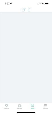

Anyways, I disarmed my system today to do yard work. When I tried to rearm the system I noticed nothing appeared on the “Mode” tab of the app. It should allow me to arm or disarm the system. Instead I’m greeted with an empty screen. I went back to the “device” tab and it says all cameras are offline.

Yesterday, all three cameras appeared offline. Also, the "Mode" tab was completely blank. I went home, deleted the cameras, reset the base, and got everything up and running again.
Today, when I woke up, the cameras work fine. However, once again, the "Mode" tab is not working again. I included a photo for reference.

Since Arlo support hasn't done anything to officially let anyone know what the problem is, what causes it, or how to fix it here you go...
If you try and reorder any of your devices your Base stations will disappear off your account. Your cameras will stay connected for live view and will say they are connected to "Base Station", your Modes tab will be empty (no base stations to change a mode to), your recordings will not save to the cloud but will save to a USB in the base station.
Here is how to get it working again.
You have to reset your hub with a paperclip. Then readd the hub and readd your cameras. IMPORTANT! Add them in the order you want them to appear in your app as once you do this DO NOT TRY AND REORDER YOUR CAMERAS. As soon as you do the hubs all disappear again and you have to do this all over.
Note this is a workaround figured out by users to get going again. The problem still remains so don't even risk it and open up the reorder option or you will start all over again.
