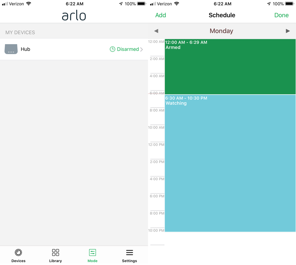

I’ve noticed that you cannot schedule modes to last past midnight and into the following day. I did find, however, that you can schedule a mode up until 11:59 one day and then the same mode at 12:00 AM the next day to attempt the desired affect. Unfortunately this doesn’t seem to work as expected. When I select modes this way:
Monday 10:30 PM - 11:59 PM ARMED
Tuesday 12:00 AM - 6:00 AM ARMED
the system will arm at 10:30 as expected, but will disarm at 12:00 instead of arm. Screenshot for proof that system is disarmed mid-armed-schedule.
This seems like a fairly important bug because it would seem the most basic requirement for scheduling would be arming over night. I know there are a lot of other uses but this seems like it would be the most common.

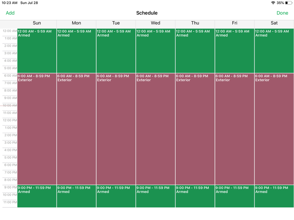

Hi,
- The issue occurs when there is a switch of Schedule(Armed to Armed) overnight in Geofencing mode. Lets say I go to bed at 10 PM every night and wake up at 6 AM the next day and I want my cams to be armed while I’m asleep. When Arlo’s schedule switches over during midnight (11:59PM to 00:01AM), this is when the problem occurs. Its stays Armed till 11:59PM and then goes to “Disarmed” after midnight. So my cams get completely disarmed after midnight.
- Base station : VMB4000r3 (firmware : 1.12.2.4_2772)
- Cams : Arlo Pro2 (firmware : 1.125.13.0_31717). I think Arlo Pro users are also experiencing the same issue.
- Refer attached screenshot of schedule
- Current workaround : get rid of 11:59 PM from schedule as you can see from my screenshot.
Regards
DC4L
VMB4000r3. FW: 1.12.2.4_2772
Geofence is set to
AWAY mode ARMS as needed.
HOME mode is set to scheduler as follows:
Exterior from 6:00a - 9:59p and ARMED from 10p - 11:59p and 12:00a - 5:59a.
System goes into ARMED at 9:00p - 11:59p.  However, at 12:00a, system DISARMS.
Ive deleted and re-programmed scheduler 3 times rebooting Base Station 2 of the 3 times,  yet problem persists.
Need suggestions please..

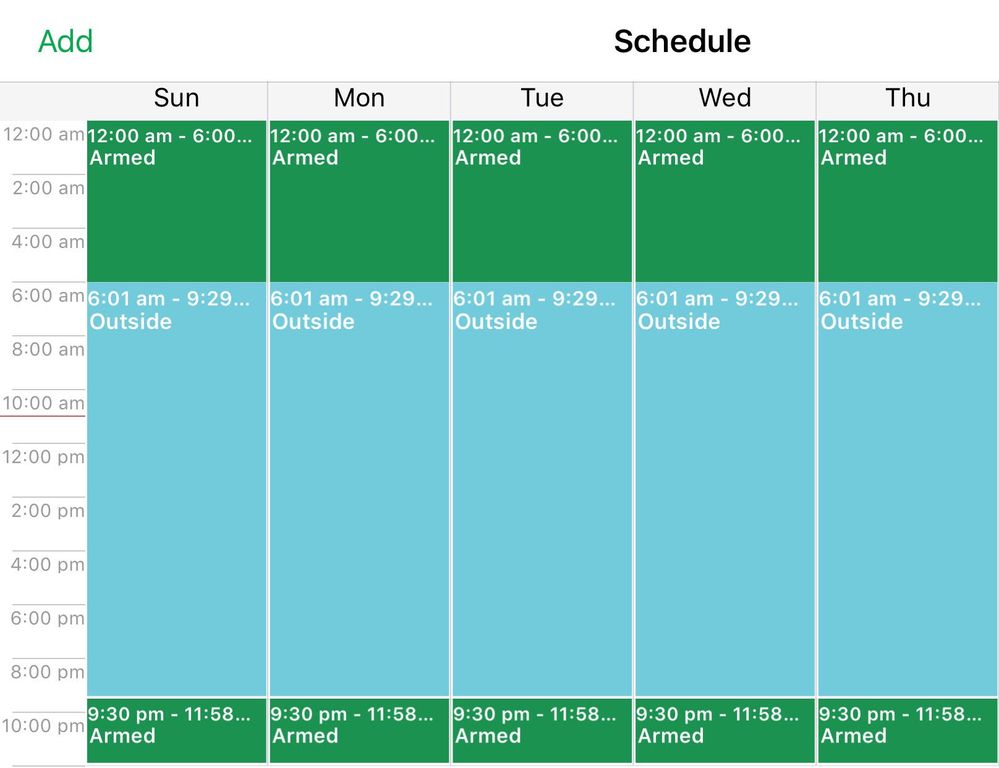

When we have the schedule start at 12:01 it seems to work and not switch to disarmed. However we don’t want to keep missing one minute of recording every day so we are not using the schedule mode now. Arlo has become very undependable as of late. We just don’t trust the system anymore. Spend so much time checking if it’s working like a babysitter. Also we don’t really appreciate when arlo tech support calls us and asks us to test out multiple scenarios like can you create a schedule with this mode start at this time and see if it works. Like am I getting paid to do this? .

Same issue here. I have a schedule that runs evening the 11:59, then midnight to morning. Cameras become disarmed at midnight.
Setting it to run 12:01 to morning works, but obviously there’s a 1 minute gap in that case.
