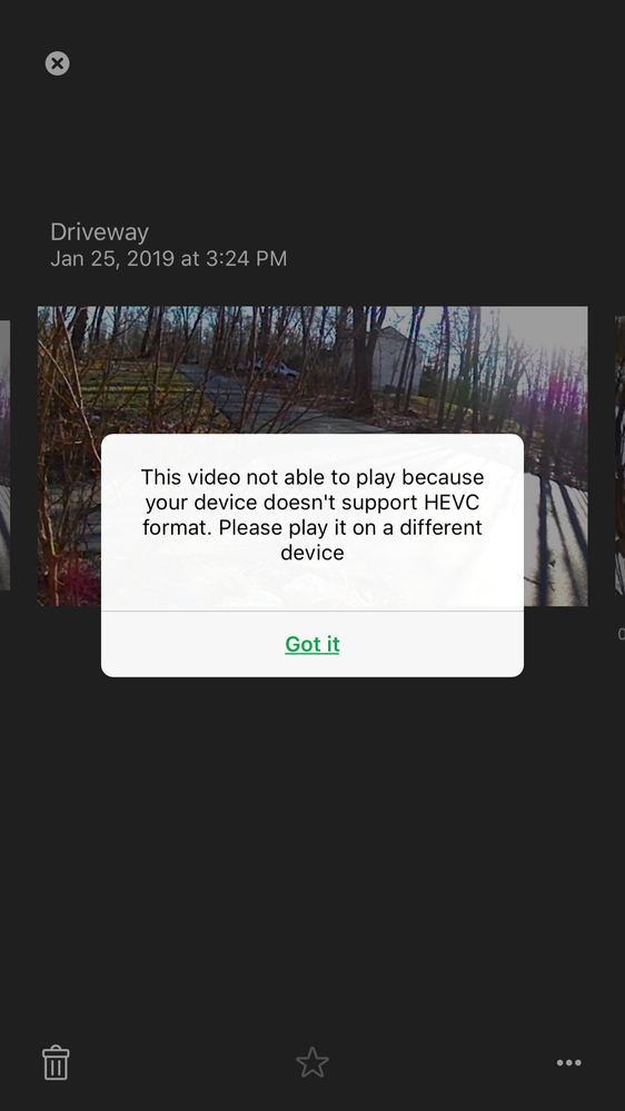

Just updated to latest iOS app and seemed to be a harmless transition for iPhone 5s using iOS 12.1. I can see that a number of issues have been addressed so the development team is making progress. One observation so far is that I get an error message when I try to view snapshots from the library, it tells me that I do not hevc support and says to use another device. Videos play fine.

How old are the snapshots you are trying to view? Do you have a screenshot of this error message?

@ShayneS,
Any snapshots taken by the v2.7.0 App. Attached is a screenshot of the error on my iPhone 5s. Also get the same error popping up on my iPad Air 2. Using the latest iOS v12.1.2. Btw unable to upload the attached photo to this post.

I also receive this message when viewing clips, though not all of them.
As I first start to view clips to review and delete them from the mobile app, everything is fine. After reviewing several clips I will start to get the message "This video not abl eto play because your device doesn't support HEVC format. Please play in on a different device". It will then play the video clip.
If I restart the app, the issue goes away for a short while, then will start again.
If I receive the message for a particular clip, I can close the app, view the same clip and will not get the message.
Does that app get into a bad state that causes this issue? It can get annoying when reviewing a large number of clips.

@MrBillf,
I believe that you may have a snapshot in your library that when the App is referring it causes the error message.
I can recreate your issue if I have a snapshot from yesterday and start reviewing today’s videos and deleting them.
To implement a work around, suggest that you delete snapshots in the library, downloading those worth keeping first.
A suggestion of why this occurs is that the video encoder is not setting the correct context for a video still frame and the App decoder thinks it is a video clip.
