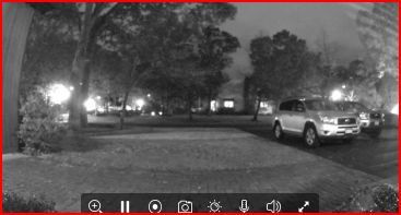

The Q camera uses Pixel change ( whn the view changes ) not a pir like the other cameras...so it allows you to view and detect motion at a farther distance AND thru glass.
Here's a pic from a Q camera ( up against glass ) looking thru andersen double pane window at night, only two external lights
