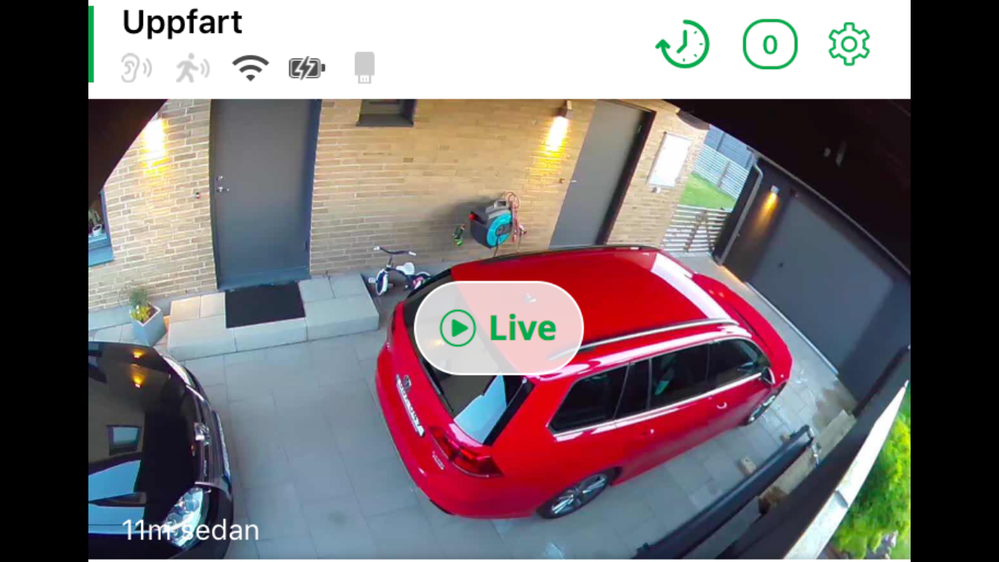

My pro 2 is always connected to power via the USB AC/DC power adapter that come with it. I have it looking at our driveway with the entrance door to our house. It also sees the street in front of our house.
I first set it up with 2 zones just covering my driveway and the house. But it still detected cars driving by on the street in front of the house sometimes. And not always picking up movement inside the zones, someone can walk up to the house and open the door and enter the house without and record of that it happend.
I then removed all zones in the camera settings (so it should trigger on the complete picture) but it still don't pick up all the motion from the entrance door, and only spodaric from the street. Maybe 2 out of 10 cars driving by is registred.
Sensitivity is set to 80%
Any hints on what I can try or what can be wrong?

It looks like the first door in your path may be outside the detection range of the cameras. How far away is that door from the cameras position? This could be why the camera is not picking up motion even though that area is within the detection zone.

It's a hard location. The vehicles in the street may throw IR reflection into the zones. The sensitivity may be too low for detecting people. I'd start by angling the camera down more. Reinstate the zones. Set the rule to 100% motion sensitivity and drop it as you get false alerts. Hopefully the regular false alerts will stop around 85-94% but you'll still get the odd large vehicle

I reinstated the zones yesterday and set the sensitivity to 100%. I can still walk from the street to the first door and open it, then continue to walk to the door closest to the camera wihout any motion is detected. It's only at the closest door it picks up motion.
I will try to reposition the camera so it sits at a greater angle towards the doors (move the camere closer to the street) and see if it makes any difference.
Frankarlo
Star
Star
Had no idea about the detection range, what is it in meters?
Anyway I moved the camera to a new position which works much better.
25 feet/8 meters is about the max for people detection.

That's funny my cameras pick up cars and people way out of that range. Well over one hundred feet.
Community Manager
Community Manager
The cameras may pick up motion beyond their intended range (especially things with a large IR signature, such as a car) but the performance is likely to be inconsistent at best. This is why for best performance, we advise placing the cameras in areas where desired motion capture will occur within the limits of the cameras range.
