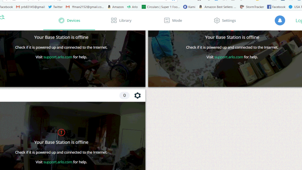

Now that you've protected your equipment, let's attack the offline issue. There have been a number of complaints about this and it's not clear to me what's going on. The fact that all 3 LEDs are on and green on your base indicates the system is working (you can test by arming the cameras, walking in front of them and see if you get notifications and videos). When this sort of thing happens to me, in almost all cases I force close the app, reopen it, let the display stabilize and there's my cameras. You can also try the web client at https://my.arlo.com using a web browser. You can use a mobile browser when you set it to use the desktop version of the site (it's in the browser settings). If that doesn't work, unplugging your router and base and then plugging them back in, in that order allowing the router to fully reboot before plugging in the base, may help. I can't be sure any of this will work since the various complaints and suggested fixes haven't been reported as successful - perhaps you can be the first.

jguerdat, This attachment displays what greets me right now when I sign in. With this type of situation, I have no access to anything in settings. Perhaps I need to reintroduce the cameras to the base station, but the base station still has three green lights showing. I hate to admit it, but the surge protector strips you speak of, I already have. But of the CHEAP QUALITY, and I must break down and upgrade at least the one for my electronics. As I tried to explain, when the power was TRYING to come back on, it was a battle between being on and being off, and if you think of a simple light switch, the on or off button, may just cause problems by shorting the switch out.
Because I was able to return all my router plug ins, it was only the Arlo that was not working as it should. So I did a classic reboot of everything, from removing all router plug ins, and even taking the router AC away from it. Then piece by piece, I started adding them back gradually, and the Arlo base station, came back on and eventually went to all green lights. But obviously, I think, each camera must be resynched to the base, one after the other, to try and remove the glitch that is affecting the system right now. Do you have any tips on how to place each camera, back on the base? Thank you.
