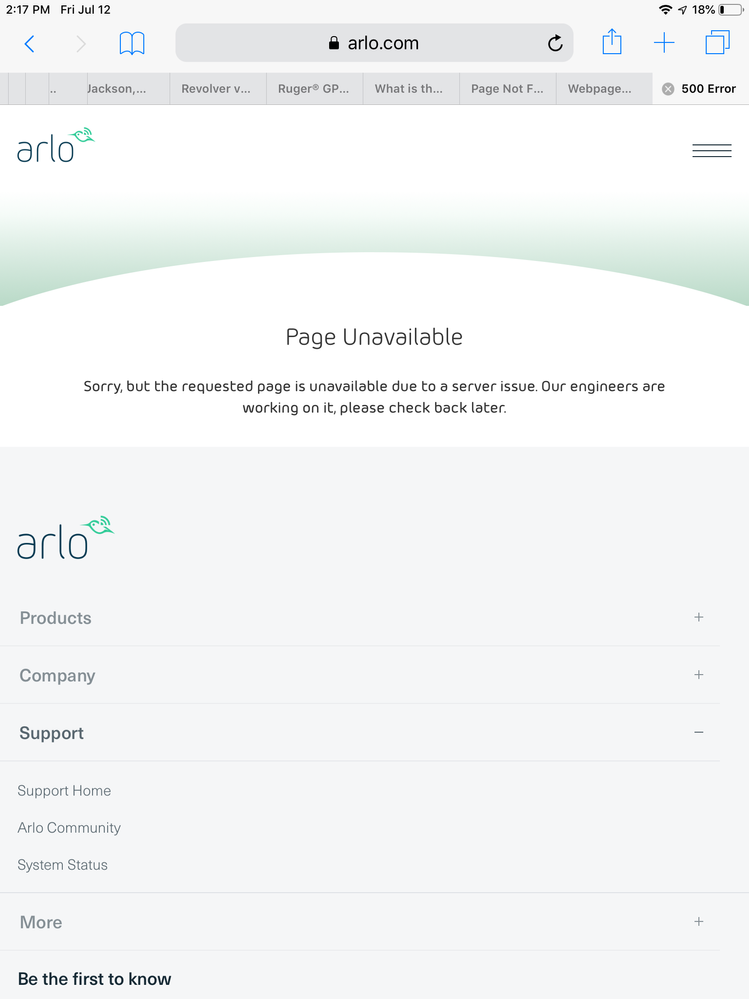

Arlo Support Case is open.   I tried to submit a description and screen grabs of the problem in response to Arlo Support’s follow up email, the web reply fails (see attached response).   I used adjusted time zones to recreate the midnight transition failures occur repeatedly as described in my earlier posts.  System resets, time zone changes, new custom modes, new schedules do not change the outcome.  The system always disarms itself at midnight if I have a schedule with the mode beginning at midnight being the same as the mode at the end of the day.  If I have uniquely named modes in the schedule (only 1 instance of all modes in a day), the the system switches modes correctly at midnight and does not disarm.  I’ll try again to get my screen captures to support so they can look into it.
