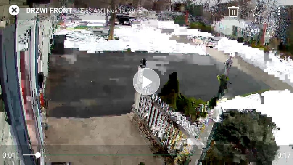

Hi all. Recently I bought Arlo Pro 2 with 4 cameras . Three of them works good and one is acting strange the picture in day or night is very kind of pixelish like little squares kind of . It start acting like that about week ago and the system is about 2 weeks old. I live on East coast so it's cold outside but my other 3 cameras working just fine. I'm attaching the picture.

Try swapping it with another camera or move it to a couple of different locations. Could be interference issues or a defective camera. If defective see if you can return/exchange it or contact Customer Service.

Im having the same issue.
I have one camera on charge inside at all times! I swapped it kver with an outside camera to charge it. The camera i brought inside is having the pixilated issue, please let me know if you solve issue.
JUST SWAPPED CAMERAS BACK AND THERE WORKING FINE!
Next time il just swap the batteries and hopefully wont have the same issue

If you set cam to live hows the pic? I added a base on Extention Router and programed the lights and cam trigers to have a bunch come on from one trigger. I noticed some bad video, were moving item would break up and part of screen would have a small diamond shaped pixilation. I think I was overloading the Extention Router transmission so cut back on some unneccesary triggers and all was fine.
