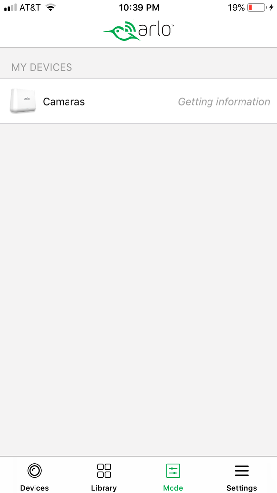

I just purchased arlo pro 2. When trying to get into mode using iOS, I do not have options, it just says “getting information”.... My friend has a arlo pro and is able to go to modes, and has pencil for editing...I don’t have that option at all.

I’m assuming you set notifications on under mode. But I do not have any active selections here. Just getting information,which it has for over 2 hours. Any help appreciated.
