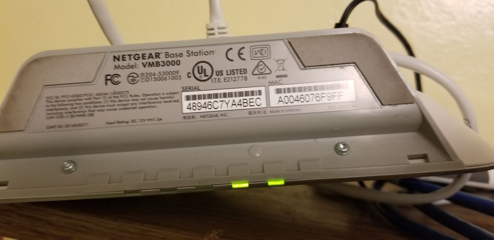

The power light and the camera light are both on and solid lime green ... the internet {center} light is off. Tried re-booting the base station {pressing and hold the top sinc button} and also tried unpluging both the power and internet contection ... nothing worked ... Also on my Arlo app under "modes" then my devices this base station shows "off" {we have another base station at our lake house which shows "armed"so the app appears to be OK} and there is no way to turn in on this second base station from the app, so that option also doesn't work ... any suggestions

Is this a new installation? What model base station do you have? What is the status of the LED(s) on the base - please give color for each, and say whether it is flashing or solid.
