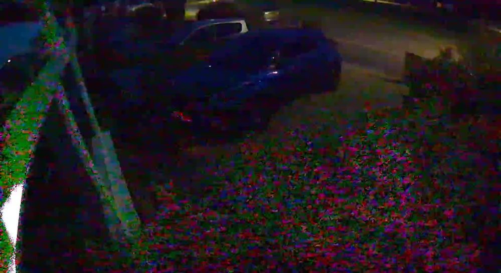

I have a strange issue with an Arlo Pro 2 camera which is not even a month old.
Night vision had been perfect and the camera is powered with the offical outdoor power supply.
Last night when I looked it seemed that the IR wasn't turned on as the picture was grainy and oddly coloured.
I tried switching night vision off and back on again, but it was still the same (see attached picture) as you can imagine I'm not too happy seeing this when the camera has only been in position for a couple of weeks.

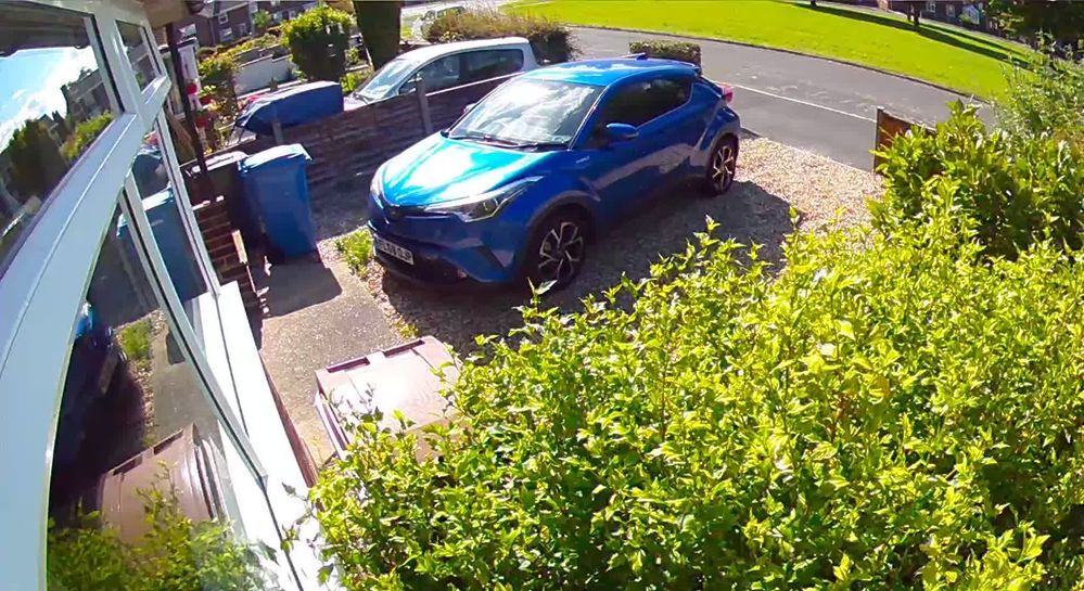

Any ideas what's wrong, during the day the image looks fine and night vision was fine 2 days ago.Image from 1st July
Looked ok on the 29th June
Daytime image 2nd July looks ok
I have same issue.. I spoke with tech support and sent photos. They verified it didnt seem to be working and sent me a new replacement which is same exact issue.. pissed
mine is horrible. very dark and greyed out. tech support said its an issue and to send back for replacement and the replacement is no different
tech support stated this was an issue after viewing the photos i sent so they sent a replacement abd new one is no different..
