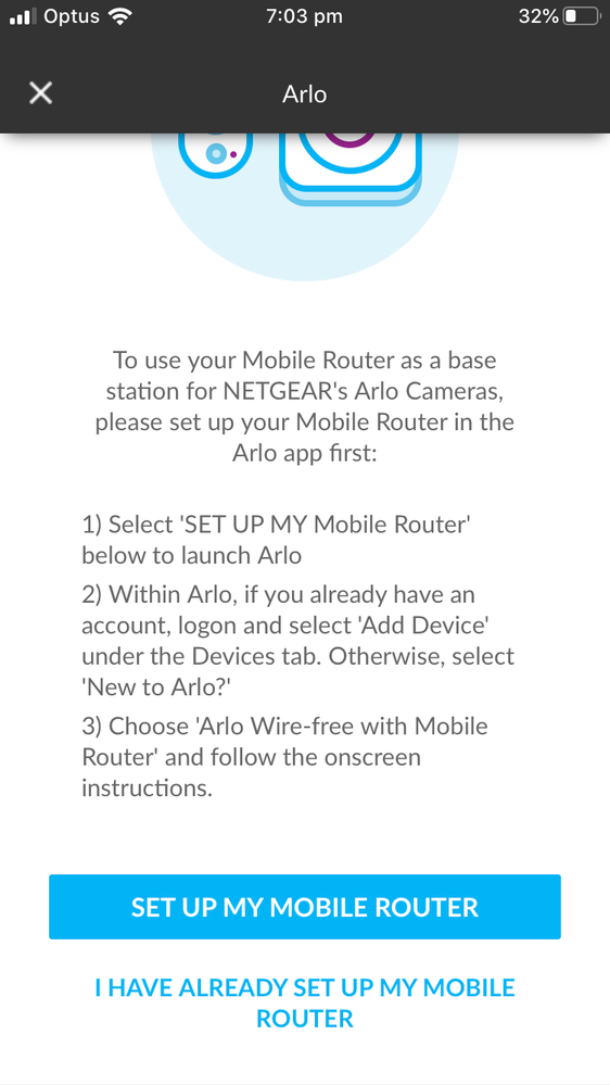

I am a new customer. I purchased an Arlo Pro 2 4 camera pack.
I also own a Netgear Nighthawk M1 router (MR1100) with latest firmware.
I have not been able to pair any Arlo Pro 2 cameras with the Nighthawk router.
Here is what I have tried so far :
1. Enabled the Nighthawk as an Arlo base station as per instructions here : https://www.youtube.com/watch?v=qxDdVzSdH_A
2. Initiated a camera pair but camera nevers "finds" the Netgear base station
3. Paired the camera with the Arlo Base Station from the box and updated base station and camera firmware to latest. Deleted camera.
4. Tried step 1 again, no success.
Has anyone used the MR1100 as an Arlo Base Station succesfully ?
Thanks, Tom
