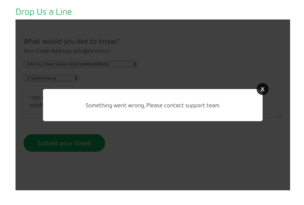

Also, when I try to contact the Arlo support team via email I get the attached error.
"Something went wrong, please contact the support team"
Deeply ironic...

Dannybear
Master
Master
This might be why.....
The Arlo Community will be undergoing a maintenance to update the look and feel starting March 12, 10:00PM PST. Learn More
gergtreble
Ok, I'll try again later.
