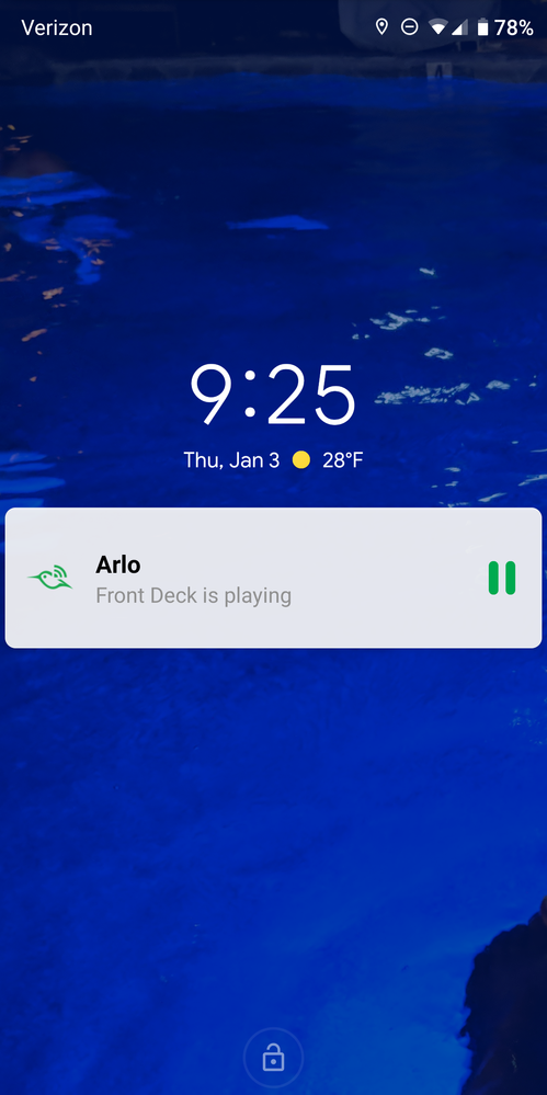

Ok, it’s about time you fix this. No, turning it off and on again does not work. Every time I look at live feed the sound stays on until I crash the app. Current IOS on iPad.
Camera sound won't stop after live feed sound unless you crash the app. This problem has been reported since October last year. Solution please or its back to the store for the second time. I will not try again if you do not try to help customers. The first set was a bad camera and you have to return all cameras with the chance that the next set might work. After two sets I give up on ARLO. 6 months and nothing but problems. Get it together Netgear.
For Iphone try going to settings, background refresh and turn off Arlo.
