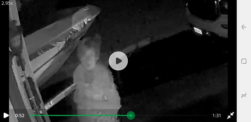

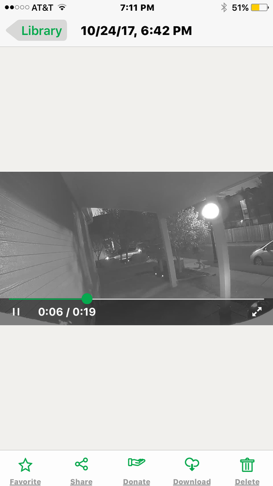

Nightvision - On battery, the nightvision on the Arlo Pro 2 vs. the Arlo Pro is not good... Haven't tried on power, but don't plan to use power. I'm really disappointed in the quality of the nightvision overall. There are a lot of dark black areas and the picture just isn't lit up as crisp with the Pro 2 vs. the Pro. Also, when motion is detected, some cameras record pitch black for a second or so and then as the IRs illuminate the picture the nightvision starts to show up. Never had this with the Pro version, worked like a champ. I hope this can be resolved in a firmware release so that I don't have to buy all new cameras...

No skins on all 12 of my Pro 2s that are seeing the degraded night vision quality over the Pro.
No skins for me either
The quality is not only grainy, but dark, little contrast. All it takes is a bit of light and the quality does go up
Rick
I use the Arlo branded skins and I had really bad washout/IR issues on my Arlo Pro 2. I knew the skins were causing the problems because I can actually see the skin producing a "fisheye" effect on the top corners of the cam (looks like a new Arlo branded skin needs to be made for the Pro 2), so I just pulled the skin back a little more so the hood can clear the IRs. Seems to work better, but the image is still washed out and is still not as good as the Arlo Pro.

Also, I had a curiousity question for those with washed out nightvision... How many of you are seeing the "ring" around your picture? For those that are, is that just how it looked from day 1 or did you change settings to get that?
I was able to resolve my night vision issue by removing the Arlo skin.
