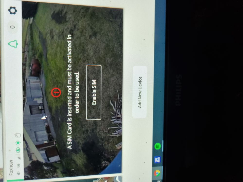

My issue started on the 5th November, I am also receiving push notification and am able to look at recorded action.
See attached photo of what message I'm getting which wont allow me to watch live feed.
Everything works fine on my mobile app.
Very frustrated so I'm keen to see if they come up with a solution otherwise I will return it and buy another brand that offers better support.
