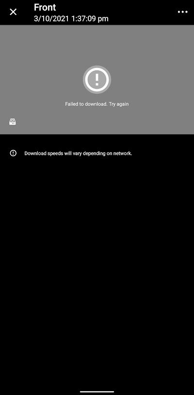

Hi all/Arlo,
I helped a family member change from cloud connected cameras to using a smart hub. Resetting each camera and syncing to the smart hub worked fine. The cameras are connected and record to external USB storage. I can see in the library the recordings, but they do not download or play. "Failed to download, try again". I tried on both iphone and Android with the latest updates and app, and both devices connected to the same network as the smart hub. The recordings are visible in Library, bit do not download/play. Removing the storage and plugging into a PC/Mac to view works. Only viewing locally via iphone/android does not. Any ideas why? Or what I should try? Everything else works minus the playback.

There is no VPN, Arlo is plugged by ethernet into the router, phones are connected to the same router over WiFi.
The this is, the library lists the captures, which tells me the app is communicating with the SmartHub. Its only when you click on a thumbnail and want to download it, it fails. (Both iPhone and Android)
Once its working internally then I intend on using VPN/pinhole to enable externally.

Just trying to post the images again. The previous ones just show black.
