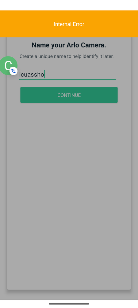

brand new pro4 camera 2 or the 3 pack worked but on one I get the "Internal Error" when after trying to name.
I just came across this problem when moving a camera to another room in my home. It worked before and was purchased a couple years ago.
Where it displays internal error

I bought mine from Costco, brand new Arlo Pro 4 XL. I'm having the same problem, "internal error" after naming the camera. Named it Door.
I having this same issue on the smart hub and individual cameras. Just purchased the Costco pro 4 XL pack brand new.
Try skipping the renaming step during onboarding, and then go back and edit the name later.
It doesn't let me skip naming on the app. I will try the web portal later today, maybe there is a different onboarding flow.
I just bought the Pro 4 camera system and can't get past naming it because it gives me an internal error. It SHOULD NOT be this hard to set up. I'm using an android phone and app
