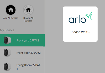

I got two essential cameras in use. I set up the scheduling from my web browser when I first put them online and it worked fine. But now when I click on MODE I can't click on the camera to make any changes from my browser. I have other cameras (Arlo pro and pro2) and those work fine. What changed? It says in the help section :
"The following instructions are the same if you're logged in to your Arlo account using the Android app, iOS app, or web browser."
Web browser DOES NOT WORK for the mode control.
HELP!

  I can't edit my previous post to add this picture...

For more than a week, in the website when I click on Mode I just get Please Wait. Nothing happens after that. The only thing I can do is to use the browser's back button. I can get into mode from my phone but not from my desktop (the website). I probably need to create a support case for this.
I am not sure what the camera is; I forget. The camera's hardware information says it is a VMC2030AerH8.
