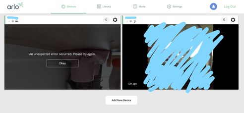

Okay, so I tried. But did not pinpoint the issue:
- Placed Essential cam right next to access point (see photo 1)
- It's using a non-congested 2.4Ghz channel (ch = 1)
- Viewed live stream via laptop (web page) and smartphone (app). In parallel.
- It will stream for about 15 minutes continuously
- Stream stops at both laptop + smartphone app, with 2 different behaviors (photo 2 and 3). One shows 'connecting' indefinitly. The other 'unexpected error'. Does not automatically resume.

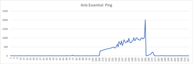

I ran an experiment whereby:
- I started the feed from the Arlo Essential Cam
- At same time pinged the cam from a laptop on Wifi within the network (LAN, 192.168.1.22).
- This same laptop pinged Google DNS (8.8.8.8) in parallel to rule out any network issues (wifi / internet).
- I ran this test for about 15 mins.
Below is the result.
What you see
- The first 10 mins the ping of both is ~5ms.
- The moment the feed stops (app shows: "Connecting..." and then hangs) is the same moment the ping to the Arlo Cam jumps up and acts erratically (1500 ms, 5 ms, 1200 ms , ...)
- It does recover after about 2 mins, but I lost all functionality (and no security footage) in those 2 mins.
Any other recommendations or follow-up? My main concern is that I frequently miss (security) footage.
I did another test and zoomed into the ping data a bit, and this behavior shows.
What could this say?
Is this a firmware issue (resource management) potentially?
