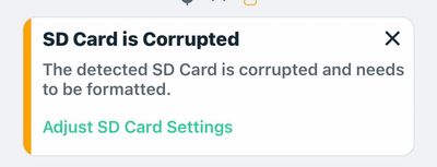

Hello. Last week, since the update for Arlo base station hub (#vmb4540r) the storage hasn’t been working correctly. Every 2-3 days, it keeps saying the storage has been corrupted and needs to be reformatted, regardless of me troubleshooting with installing different usb drives. It was working fine with no issues for over 5 months.
This is becoming very nuisance. I spent too much money on these security devices to not have them working.
Ps the hub software version is 1.21.0.0_1377_a58d08a

The same thing just happened to me, can’t go into my recordings even though I see that there are a number of recordings and this is the message I got
And there is no option to adjust the SD card setting as far as I can find.
I disconnected the base, erased the App installed again.
no change
If anyone has come across any suggestions how to fix this?

When I open the app, I consistently receive a pop-up to purchase a monthly subscription. I click 'no thanks' just to see the red USB symbol indicating a corrupted file. Then a re-format becomes neccessary and all previously recorded video is lost. I've tried resetting the base station and all five cameras, and I tried different USB's. This is a major failure in the produt and it needs to be addressed urgently.

For the last month or so I am getting an SD card error.
1. In the Arlo app where there is a list of cameras, an orange circle with an SD card in it comes up in each camera preview window. When you click on it, a message box opens "IO ERROR. There was an error writing to SD card." When you go to the storage setting, it says: Insert a Micro SD card into your SmartHub to start storing recorded clips locally.
2. In short, the Smart Hub VMS5340 is not recognizing my SD card.
3. It was working absolutely fine for the last 11 months since I installed the system. SD card was working fine. It's SanDisk High Endurance 256 GB card. I formatted the card, it works for a day, and then same issue. I tried with 2 different cards with low capacity, same issue - works for a day and then the same error. I checked - there are no updates available.
