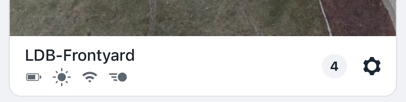

In July 2022, I purchased a new VMC2030 Essential Spotlight and a VMS3600 solar panel to replace an older Arlo camera/panel at my front door. I can see the panel is detected because I get a solar icon on the status panel.
http://www.thislivetest.com/status.jpg
However, I never get any indications that the camera is receiving a charge, even on a bright day. My old Arlo camera/panel charged quite frequently in the same location. I had to take the camera down on January 2 to charge it manually since the battery was dead. Over the last few days, I've been logging the battery level every morning:

Basically it says it has a solar panel attached but the panel does nothing. Guessing the panel may be defective?

If you will snoop around a little bit on these discussion groups, you'll find out that it's not the panel, it's the version of the app you are using...
I have looked around through this forum and am not seeing what you're referencing. I'm using app version 4.0.3 which is the latest for iPhone.
I did find this knowledgebase article that shows what the various charging icons mean. Since my solar icon and battery icon are both black, it appears that indicates the battery is not charging. It does indicate that a solar panel is detected because otherwise there wouldn't be a solar icon at all -- my other cameras without solar panels also lack this icon.
https://kb.arlo.com/1179176/What-do-my-Arlo-camera-s-battery-level-icons-and-notifications-mean
If you'd care to provide a link to one of these posts about the app being the problem, I'd appreciate it.
