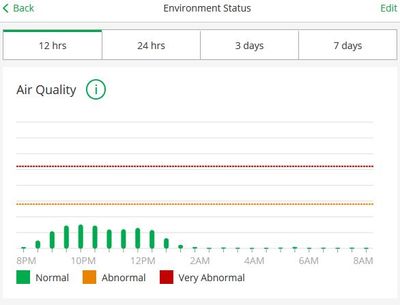

These alerts only take place after my 2 year old has gone to sleep with the door closed.
The air quality levels always come back to normal in the morning.
I live in a desert climate. The bedroom size is about 11'x11' and temperature measured by Arlo Baby and Ecobee3 sensor stays between 68-74 degrees. Hummidity between 30-40%.
Things tried to date:
1) Picked up a high quality HEPA air purifier as well as a humidifier. No impact.
2) Left the window open to "air out room" several times during the day. No impact at night time air quality.
3) Permanently removed diaper trash pale from bedroom. No impact.
We've left town a couple times and during thos times I left the bedroom door closed. The air quality remains normal throughout the entire day and night and at the very bottom of "normal scale".
Bottom line, the only time the air quality degrades (at least per the Arlo Baby) is when my 2 year old is in the room sleeping.
What can I do and should I even be worried?
Thanks

As noted in my post, I've tried #1 and found that the air quality levels remain normal (they barley move from the bottom if the graph).
I will try #2 and a reset to see what happens and report back.
Thanks again.
diaper at night condition causing VOC ?? 🙂
The abnormal air quality literally starts within 15 mins of him going to bed with the door closed.
Even with the door closed all day while we are at work/daycare, the air quality stays in the low green.

Even with a HEPA air purifier running 24/7, I still get abnormal readings at night and normal readings during the day. The door is closed at night but the door has a 2 inch gap at the bottom which allows plenty of air to enter and leave the room. Furhter the ARLO Baby is mounted in the corner of the room about 7 feet above the floor (6 feet from the crib and 4 feet from the HEPA air purifier).
My LO sleeps from 8:00pm until almost 7:00am. Whats strange about the abnormal readings is they typically start at 10:00pm, gradualy get worse until 2:00am then they start decreasing. By 5:00am the Air Quality is within a normal range.
