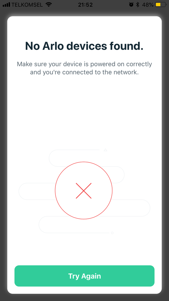

Arlo Baby connects to WiFi but fails to discover. But works fine when setting through HomeKit.
Hoping to get some advice on other options to try to get the Arlo Baby to discover.
Methods attempted so far (each time performing factory reset, and power down in-between):
- iPhone Setup (results in solid blue led, but fails discovery)
- Android / PC setup (connects to wifi via QR code for 2 seconds I can see the successful connection logs in my router, but then it disconnects and returns to flashing amber)
- I have tried various flavours of network setups to try and connect with (hotspots, simplified SSID, etc)
I know it can connect to my wifi, as setting up via HomeKit works, and I can see and use the camera via the Home app on all my devices, but HomeKit integration alone is not enough to update the device / control the LED.
I can see from HomeKit that the camera has Firmware 1.8.17209.
Any suggestions greatly welcomed 🙏
Is it possible to perform firmware upgrade manually via USB?

I have only once successfuly conntected to the Arlo Baby via Homekit when performing setup via the Home app. I have never been able to successfully contect to the arlo baby via Arlo app.
When using the Arlo app, 7 out of 10 times the Arlo baby successfully connects to the wifi (solid blue light), but then is never found during the 'detecting/discovery' phase.
Similar occurs when setting up via the Home app, the Arlo baby is picked up via the Home app, and begins sharing wifi credentials, then the ARlo baby light goes solid blue, and then... nothing, the Home app fails to complete adding the accessory.
Multiple factory resets, multiple wifi setups attempted.

i have the exact same issue. I’ve had an arlo baby for a few years now that works perfectly but I purchased a new unit this year and have not been able to set it up in the Arlo App.
i returned the “defective” unit to Arlo and just received my replacement unit, I am facing the exact same issues with the replacement unit. I do the setup using the arlo app on my iPhone but keep getting a “No Arlo devices found.” message. I did the factory reset, delete the app, used an android device, used a laptop, tried on a different router, etc. And still no success when using the Arlo App.
When i set it up using apple Home it works fine but I don’t have all the functionalities.
