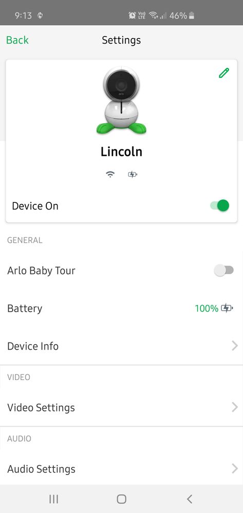

bluelighthater
Yeah I'm using Android. I attached a screenshot to my first message, there isn't a setting anywhere
JessicaP
Arlo Employee Retired
Thanks for that screenshot. Are you the account owner or do you have grant access to the Arlo Baby camera? If you have grant access, make sure you have "Allow Access Rights" enabled.
Neal_ArloPLM
Arlo Employee
Arlo Employee
Hi @bluelighthater  - the Arlo Baby status LED can only be controlled from the device Owner account.
