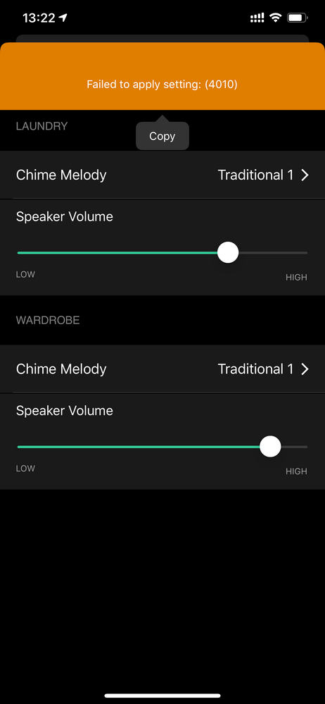

Vvv007
The same problem. After synchronizing the second chime to the same ring the 4010 error appears and the option to choose melody disappeares. Why is it mentioned in the support docs that it works when it doesn’t at all
Dutch_Arlo_User
You might want to try this workaround as my Audio Doorbell now works as expected with two Arlo Chimes;
https://community.arlo.com/t5/Arlo-Audio-Doorbell/Workaround-for-adding-a-second-Arlo-Chime-to-an-Ar...
