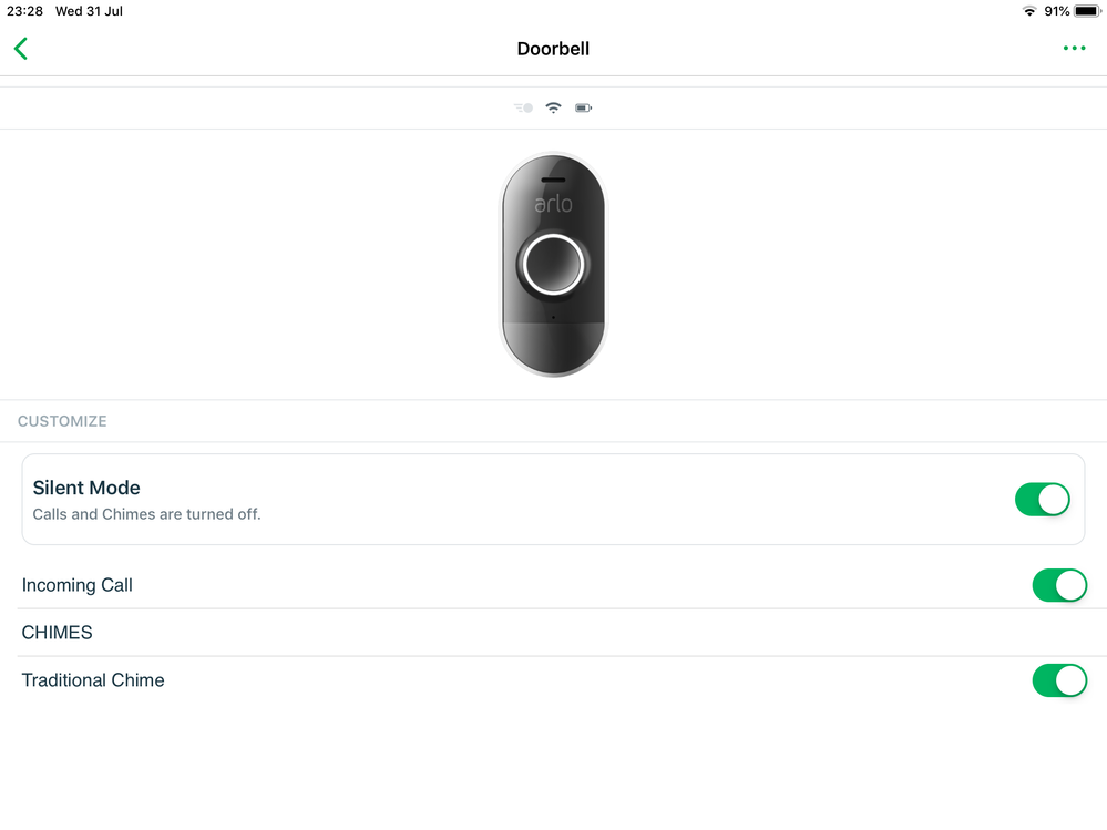

Under customize, I only have the Silent Mode option. When that is active I get the Incoming Call option.
Nothing I do brings up the Traditional Chime option.

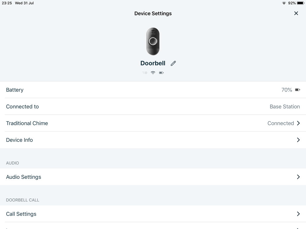

About a month ago the chime stopped working, although my iPhone would ring when doorbell pressed. Read through a lot of post and saw some success using Chromebook or Android. Then I found the post saying that the iPad has a different menu to the iPhone. Well it does, currently.
So those of you lucky enough to have access to an iPad can go to the ‘device settings’ option under doorbell (you can get to it by tapping on the three pips, top right hand corner) and you should then see the option for traditional chime. You can then complete the configuration as per instructions.

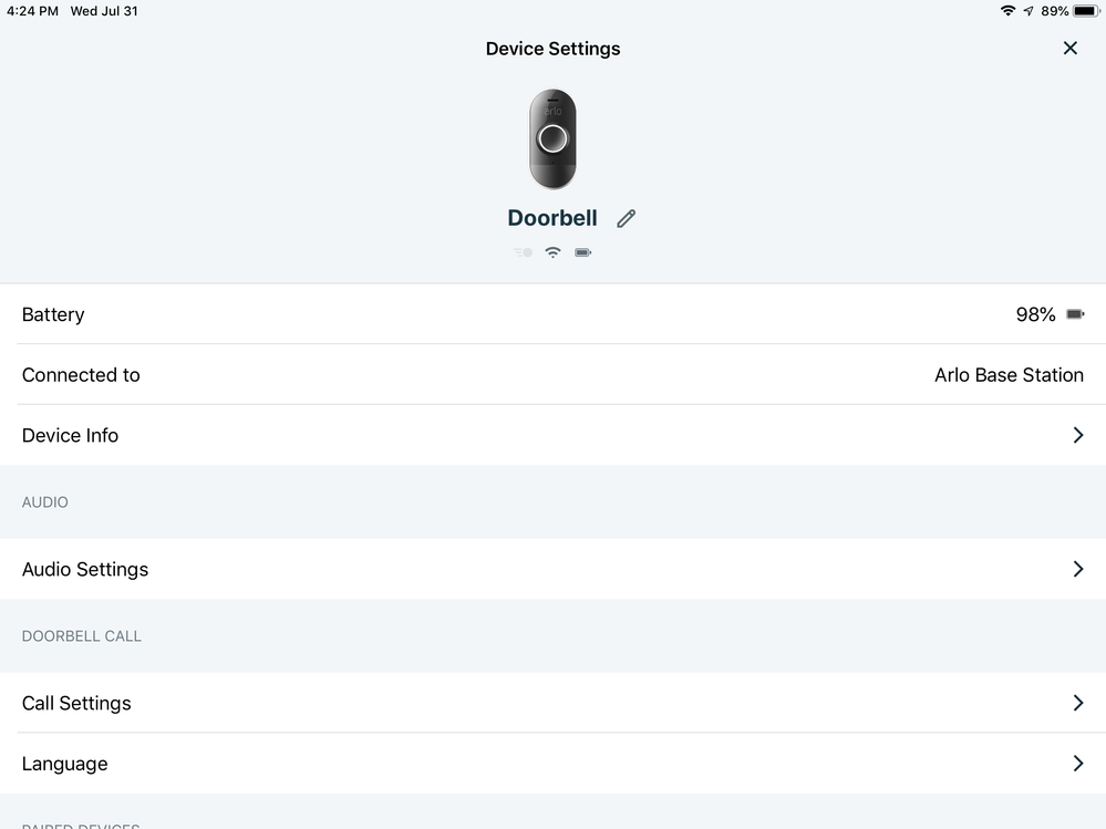

I have iPhones and iPads. My IOS versions are al updated to 12.4 yesterday. All I see under doorbell is Battery, Connected to, Device Info then under another subheading of Audio, it says Audio Settings. Unfortunately there is no Traditional Chime under the Device Info like it says with the Chromebook. I do remember seeing it there back in May, but it hasn’t been there since. I find it interesting that you can see it though. I’m also running the Arlo App firmware of 2.7.12. I compared both iphone to iPad and they are identical without the traditional chime present.

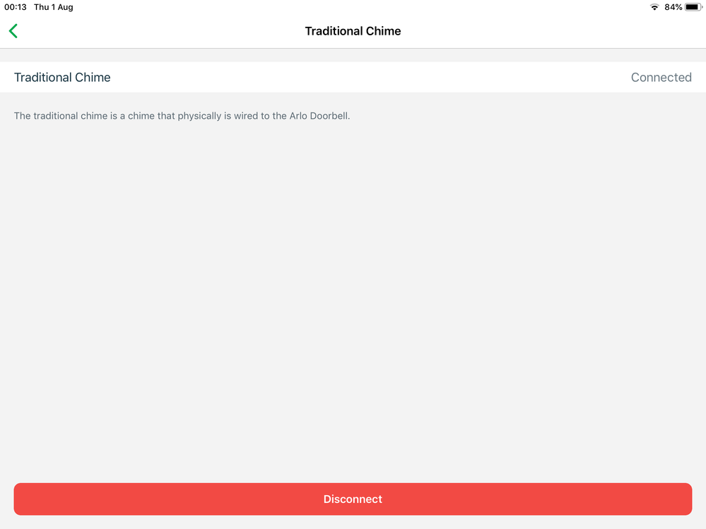

Here’s the screenshot when I go to the traditional chime setup menu. It wasn’t connected at first but now it is.

MrKeet. I guess that’s what I get for keeping my devices up to date. Attached is a snapshot of my iPad and it’s current Arlo doorbell device settings.
Hi RichWen the last screenshot is where I was able to configure traditional chime on the iPad. Before configuring I think it said ‘setup chime’. After configuring the option now shows ’Disconnect’ right at the bottom in red. I would press it but knowing my luck the option to setup again might disappear. 😩
Hello MrKeet. There isn’t any mention of traditional chime in any settings on this IOS device. It does however say that you can add a chime under Paired Devices similar to what I’ve done pairing the doorbell to the Front door camera, but other than that...the traditional chime has disappeared.
