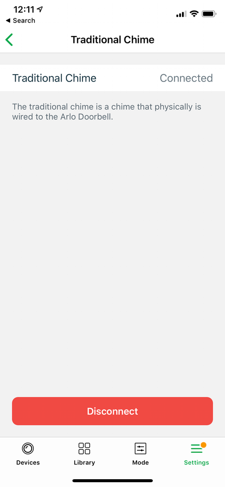

1) Go to the Doorbell in the app
2) Open Device Settings
3) Click on Traditional chime (Mine said not connected)
4) Follow the instructions
After doing this it had me set the doorbell to Setting 2 and it works perfectly.. I have a mechanical chime.

Found this solution in another thread. I was having the same issues as many here with settings 1 and 3 buzzing. Setting 2 would do nothing (no chime, no buzzing).

This solution worked like a charm! THANK YOU!! No additional parts or pieces necessary! ARLO, if you are reading this please put these steps in the setup guide to save people ALOT of frustration for such an easy fix.
The solution that I am referring to, since it is not obvious in my first reply is to go to the "Doorbell" then to "Device Settings", which is not obvious (3 dots (...) at the top right corner. Then choose "Traditional Chime" and follow the guide. Would not have found this if not for another post here trying to troubleshoot the doorbell, as it was not in the set up guide.
