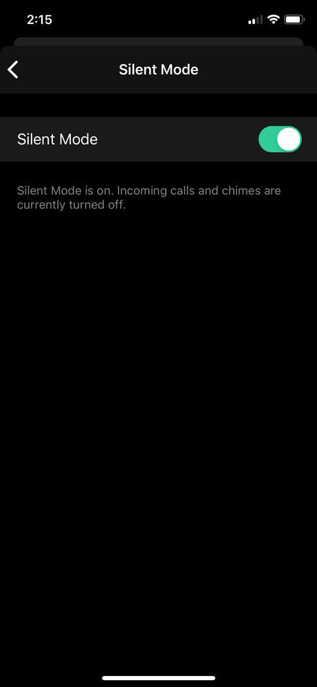

No problem, see below. The options for toggling them individually are not present. Mine is a video doorbell.
Thanks for any insight!
Hi @Dville
I apologize for the confusion, I initially thought you were referring to the Arlo Audio Doorbell. The Arlo Video Doorbell currently does not support silencing calls/chime separately.
Thanks, Shayne. Are there plans to add the capabilities in the future?
I wish I had that info for you. I would not say yes or no, we have implemented many features after launches. I would suggest keeping an eye out for any announcements.
