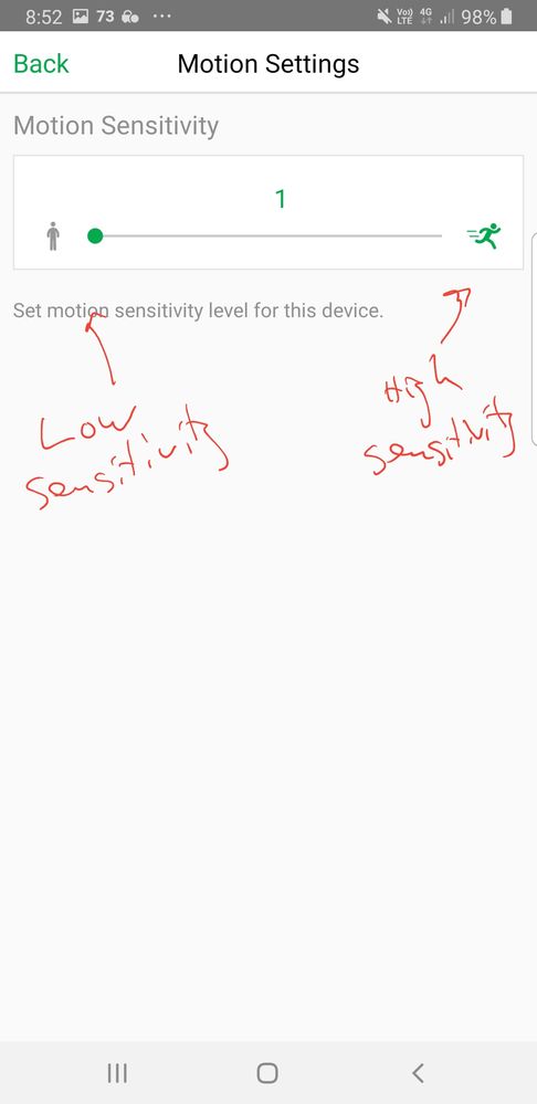

Awaytravelling
Seems like motion sensitivity setting now available.
Click " when motion is detected " to get to motion sensitivity setting.
I had the same issue as many in this forum and just change the motion sensitivity settings and haven't had a false alert since I changed it this morning.
ShayneS
Hi @Awaytravelling
Do you happen to have a screenshot of this setting you adjusted? Thank you
Greg722
Awaytravelling
Sure here are some screen shots.
I also just noticed that the setting is available on my android phone but not my iPad.
Screenshot_20200130-085132_Arlo.jpgScreenshot_20200130-085151_Arlo.jpgScreenshot_20200130-085231_Arlo.jpg
ShayneS
Hi @Awaytravelling
The Arlo development team is currently investigating reports on this missing sensitivity option with iOS. We will provide an update as soon as we have more information to share with the community.

Hello Community,
Arlo Audio doorbell does not allow for motion sensitivity adjustments by design. The sensitivity adjustment settings for this that do appear for Android mobile app users is a bug and these settings are non-functional. The development team is exploring options to allow users more control over the sensitivity of their Audio Doorbells. Stay tuned for an update on this issue.
