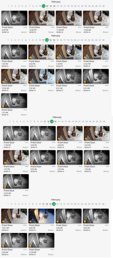

My Arlo doorbell regularly (every 1,2,3 or 4 hours) triggers from supposed detected motion and alerts me and perfoms recording. See the image of 4 days of such recordings. There is no real motion - the trigger is sourced in the cloud service I believe as the regularity (nearly on the hour or +61 minutes) is too regular; there is no motion in the recording. Nothing is this periodic in a naturally chaotic environment - lest it be that the trigger is being caused from some probing WiFi or something which is impacting the doorbell. 2.4GHz is surely noisy here. What's the reason and what's the solution? I don't like being alerted falsely so often of course.
