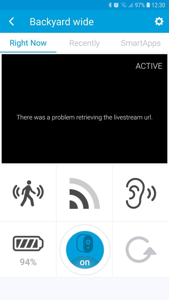

I have two Arlo Pro 2 cameras, along with arlo doorbell and chime, using a VMB4000r3 hub and two Arlo Q (Hardware: 6) cameras. I used to be able to stream any camera fine in smartthing but now get the error of "Unable to retrieve video URL" and takes about 20 seconds to see the error. Where as in google home I almost instantly recieve a "Not Responding" error in 3 seconds.

Yep, I have all Pro 2 and the video streaming still stuck in what the attached screenshot shows....
bspalding100
Yep. Same issue here. The ST stream takes about 15 seconds to fail, but the Google stream immediately gives an error.

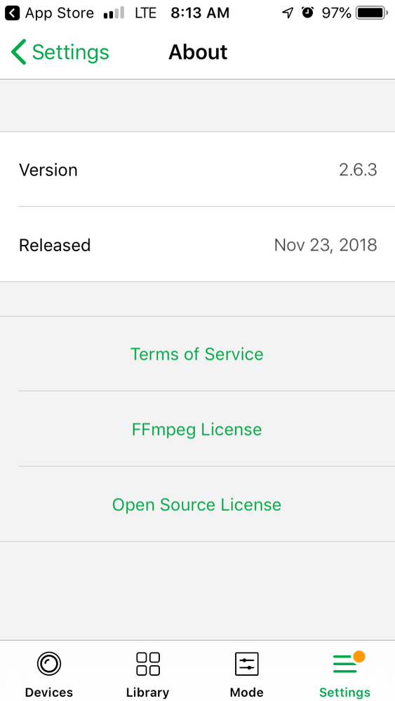

That is good to know. Can you tell what version it is? This is the one that doesn’t work.
SantanderUSA
The version is 2.7.0 from 01.08.19.
I got the streaming to Smartthings but i still cannot get Smartthing to record.
