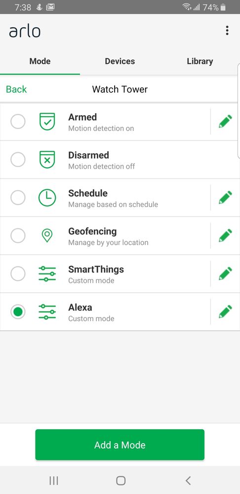

RsekX
Figured this one out, it has a similar "Requirement" that smarthing has. I have successfully activared routines on 2 of my cameras and will do so for the rest after sharing this. To get Alexa to listen for motion from Arlo I had to create an Arlo mode called "Alexa" and set up my rules there. This was also necessary for SmartThings. I did NOT have to remove/disable/enable skills or devices in Alexa. However it did take a few minutes to take effect. On an additional note, I created activity zones and am not sure if this is a requirement. The last note is that this worked on both a camera with a subscription plan and one without it.
OnoriaPTN
That is great RsekX. Can you explain a bit more what you mean by creating Arlo mode. Was this on the Arlo side or the Alexa side? Do you mean a group?
RsekX
This was on the Arlo side, you have 3 tabs, the first one is "Modes" and at the bottom you have the option to add a mode, see screenshot.

RsekX
From my last post where it wojld sometimes work, It is now working fine everytime. I haven't messed with Alexa, Arlo or my lights since then but will share more info. It could be a difference in the setup for which it doesn't work for others. For Arlo, I have arlo pro 2 and pro 3 cameras, all connected to the base that came with arlo pro 3. In the app, I created a new custom mode and named it "Alexa", within the mode I have a rule for each of my cameras to detect motion and record until motion stops on the same camera. I also set up activity zones to target the traffic areas, but they are almost the entire view. In Alexa, I created multiple routines which seem to all be working. Most turn on or off a light, one will notify me of visitors.
Focusing on my hallway camera/light/routines. I have one routine to tun on the light when motion is detected between 5pm and 7am. I have a second routine to turn off the light when motion is no longer detected for 3 min. For my lights, I have Philips hue. At one point I had created rooms and assigned lifhts to rooms within Hue but ended up removing the room and left cameras on their own. The reason for this was that in Alexa a device would be added for the light and another for the room but it didn't make much sense to have a light room and a light inside of an Alexa room. But I did notice that if I selected the room as the light (since they had the same light icon), I would get different options when setting up the routine.
My lights are on a network repeater and in a way are not on the same network as my lights.
I also have Ring door sensors that will trigger routines in Alexa to control some lights as well. I really haven't had an issue with the multiple pieces of the puzzle lately and leads me to believe there might be some machine learning within Alexa to get better at effectively using routines. At first when the triggers would sometimes not work I would manually activate the routine on my phone when I moved by the sensor. With that in mind, my recommendations would be to also check if arlo is recording each time you move by it? If you don't have the camera active (recording, sending an email, message or siren) then it will not send anything to Alexa either.
