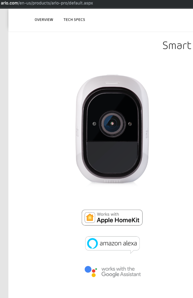

And for what it's worth; "Works with IFTTT" is no longer present on the Arlo web. 😕
Smartthings also broken and taken off Arlo's website too. Poor treatment of customers!
