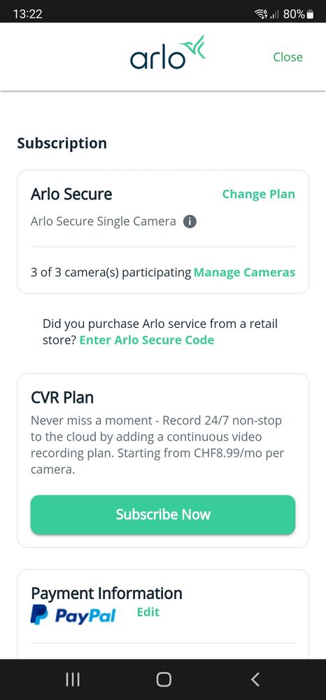

m4f1j0z084
Of course, all cameras have an active subscription. See SS attached.
