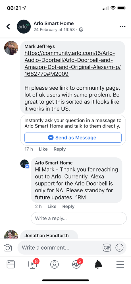

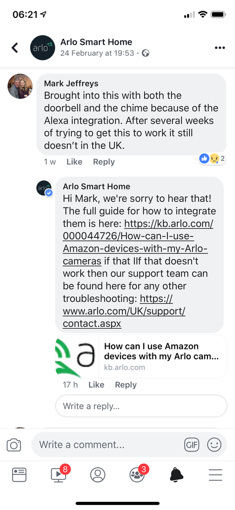

I think we can safely conclude that the Alexa function for door bell simply does not work...
At least not in uk anyway, mines been switched on in Alexa settings for a good few weeks now & still doesn’t work...& still no real constructive comment from Arlo themselves on this, I really want to continue both suppprting & investing in Arlo products but if this is the quality of support & product for end user, I think I may hold of future investment...
Arlo speak to us on this !!!
We have all been more than reasonable awaiting a solution to this issue & the relative silence from Arlo realises all sorts of questions...starting to feel I’ve been missold the product as it currently does not do what it says...Very disappointing especially with no word from Arlo on this....
Arlo: We are asking for an official response now, this has gone on for too long!
Just thought I’d check Amazon uk & noticed the ‘works with Alexa’ phrasing has been removed from the main header...
Still nothing then ? Arlo ?
Just thought i'd poke this one again...
Still not working with Alexa as 'was' advertised...
