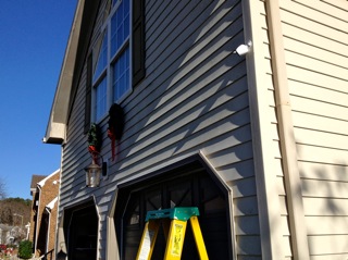

The goal here was to mount our front-of-the-house cameras in such a way as to cover the entire driveway & approach to the front door, but without having them trigger on every single flippin' car that drives past (we live on the main street through our neighborhood).
Disclaimer: This solution was not my idea—I totally ripped it off from StuBee, based on a post he made back in May.  Since he never followed-up regarding whether it worked or not, I figured I'd give it a try and report my results.
I started off with a 1.5" tube, as StuBee described, but I cut the end on a 45º miter so it wouldn't be visible in the camera's field of view.  This resulted in a very tightly focused motion detection range; it seemed like the "hot zone" was just a couple of square feet of driveway.  My final version wasn't so much a tube as an awning above the motion detector dome, with camera mounted upside-down so the lens is below the detector.  It might not be necessary, but since the cameras are upside-down and exposed, I covered the 1/4-20 threaded socket and the battery compartment release latch with a piece of clear packing tape for a little extra weather protection.  Cheap and easy to replace when batteries are swapped out.
One cam is mounted 9-ft high on the left side of the garage by the front porch.  The other is at the same height on the opposite side of the garage, aimed higher to view the entire driveway and part of the street.
The left-hand camera is hard to see in the first shot above, but is just visible against the brick of the next-door neighbor's house.  The second shot is a straight-on view to better show the shape of the shield.
Each shield is made from a piece of 3/4" PVC tubing that I cut on a miter saw and shaped with a file and emory paper.  Right now, they are just stuck on with a bit of adhesive putty, but that will lose its grip as soon as our East Coast December heat wave is over.  When I'm ready to attach them permanently, I'll use a small bit of outdoor-grade double-sided tape.
I knew right away that this solution was going to work, since it's trash day today and neither the garbage truck nor the recycling truck triggered motion when they emptied our cans.  Same with the mail truck, several school buses, and numerous cars.  Previously, every single passing vehicle going in either direction would trigger the cameras, so during the morning and afternoon drive times, the cameras were being triggered every couple of minutes.
I had mitigated this somewhat by turning the motion sensitivity all the way down on the camera furthest from the front porch and created a rule to make it record whenever the porch camera senses motion.  This is no longer needed, so I now have both cameras set at 100% percent sensitivity.  Each camera also has a rule to activate the other when motion is sensed, so I always get two recordings for every event on driveway & front porch.
